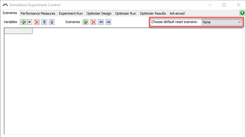

The user's manual states "After the experiments are over, you can watch an individual run of the specific replications you are interested in" but I can't find how to do this. I would like to know how to use this feature.

To watch an individual run of the specific replication you are interested in, you select the scenario in this dropdown:
And enter the replication number in this field:
Then run your model normally.
Also, ensure Repeat Random Streams is checked in the Statistics main menu:

I am unable to get this process to work. I ran in the experiment with16 replications and the eighth replication had a very high average LOS, significantly different from the others. I follow the process you described, ran the model and it got a much smaller, normal average LOS.
I remember that FlexSim HC had this feature which I used frequently to watch a particular day unfold. Really a great help.
Any other suggestions?
philboboADSK
It is hard to know what is happening if you are just describing the situation in words. We can't determine what is wrong unless we can replicate the issue.
In order to debug what is going wrong, it would be better if you posted your question in a new private question with your model attached.
