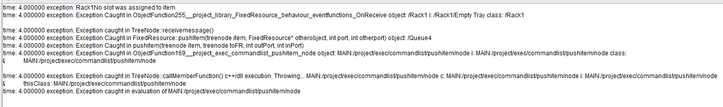

I have a problem in my model with the rack filling with the initial stock. I want to put on the shelf some initial stock that make the AGV able to work from the start of the model. So i define a source and a queue and the output logic with the global list that I have defined in the model.
The source create the object flow, but the rack isn't able to find a position for the object. I tried the solution with the create object in the process flow but the result is the same.
I attach the script of the error and a copy of the model

The items you create as initial inventory are missing the "LoadUnit" label, that you use for slot assignment. That's why no slot can be assigned.
