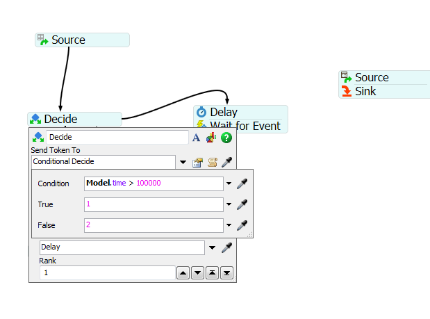

Hello, I'm a decide and wait for event to loop tokens until a condition is true.
The condition is a certain day when I'll allow my token to continue.
I'd like to use a wait for event activity that allows the token to continue every day.
Any idea how to do it?
93 Views
andrew_rooney
I would use a Date/Time Source set to Daily repeat to generate a token at the time you want to perform the check. Set the Object in the Wait for Event to the Date/Time Source and the Event to On Exit.
In the Decide I would expect you to use the Conditional Decide and a condition based on, for example, Model.time
guillaume_v
Thanks @AndrewR that's exactly what I needed
