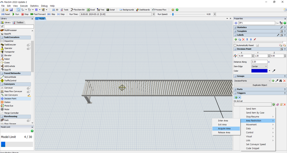

If you upgrade from version 23 to version 24,
You'll see that the require area function in the area restriction category has been replaced by the allocate control area.
I need an Enter area function, where has this function been moved?

"Enter Area" has been superceded by the new "Allocate Control Area" that utilizes the Control Area object from the AGV/A* category to act as the 'owner' of the area. It thusly allows you to have an interaction between task executers travelling in those networks and items on a conveyor.
If you want to use the old option (I can understand, not needing an extra object is 'neater') you will have to copy the code from an earlier version of FlexSim. I have attached the pickoption code below.

No, the pickoption was removed. Using the new version with a control area or copying the code are the two options you have. Though once you do copy the code, since it contains the necessary markup, you can edit the function parameters in the trigger GUI as if you had added the option there.

what is the control area? how to use? you mean control area is acquire area? but how to chage count at acquire area?
Message 7 of 10
moehlmann_fe
The control area object that was previously only used in AGV networks. It can now also be connected to an A* grid or allocated via code, which is what the new trigger option does.
You set the maximum number of allocations in the control area's properties.
