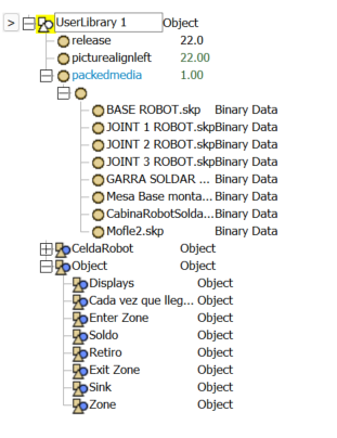

In the end it's easier to just copy the packed media node from the model and paste it into a new node in the user library attributes.
TestPackedMediaRobotLib.fsl

1.- I add the plane into a new user library:
2.- I go to the Tree and I copy the node "packedmedia" (Ctrl+C)
3.- I go to the UserLibrary that I created (in the Tree)
4.- I select UserLibrary1, then I right clic --> select "Node" --> select "Insert Into"
5.- I paste the packedmedia in this new node Ctrl+V)
6.- I save this library
7.- Then I tried to import tis library into a new model and I get the error message:
Thanks a lot for your help!
Fanuc.fsl
