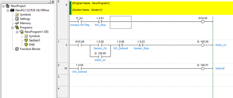

In this project. I use Omron PLC CP2E-N30DT1-D
And I hope the answer and solution in my question will be helpful for other at they want to build the project about emulation.
I has building ladder of PLC in CX-Programing. The equipment consists of 2 object detect sensor, conveyor set controlled by motor and 1 air solenoid for push item to conveyor.
So, I create the 4 address at symbol like the picture and each symbols will be Boolean type.

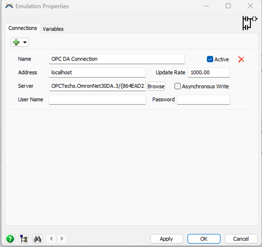

And I use OPC TechNet for try to connecting between PLC and FlexSim Emulation.
I use OPC Tech at Demo version.
In FlexSim Emulation I use OPC DA Connection and I found OPC server and connected.
Them, I create 2 Sensor Tag and 2 Control tag like the picture an it same in picture of my OPC Tech window.

I try to use variable in process flow from your advicing.
Once of variable will be OPC DA Connection. It can Browse to OPC server at the same in connection of Emulation Properties.
But in Control Tag and Sensor Tag variable it can't Browse to OPC Tag. Even though a Control and Sensor Tag in Emulation Properties they can Browse to OPC Tag.
