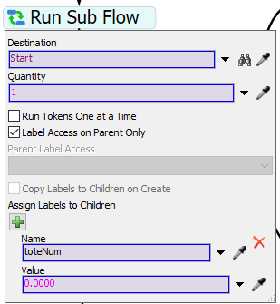

The first one happens at 6496.507 and it's because you don't reset toteNum back to zero, so the second time the agv goes to unload, toteNum is already set to 5.
You can reset the toteNum in the RunSubFlow activity:
