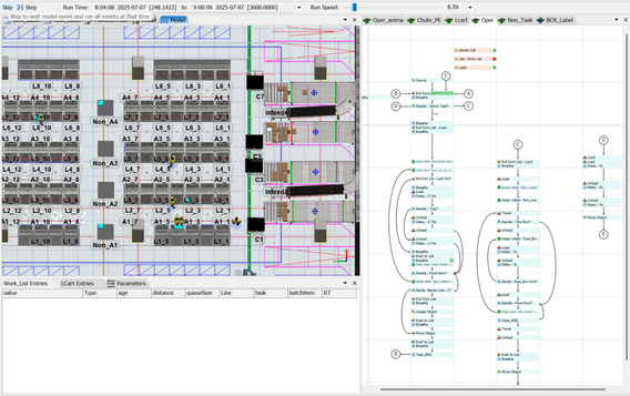

Hello.
I finished the modeling and ran it at 8x speed. However, starting at 248 seconds, the Model screen freezes and there is a bug where the process flow tokens move rapidly.
I would like to know the cause.

It very much looks like the token is stuck in an infinite loop. You should be able to stop the model and step through one event at a time to debug the Process Flow.
jjm777
Thank you. I made a stupid mistake.
