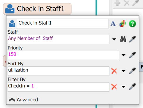

Alternatively, you could use the "filter by" function on the Staff shared asset to only select staff with a certain label (e.g. CheckIn) and then change the label value whenever you want to change around the staff:
With this method, you would need to change the CheckIn label on the Staff member to 1 when you want to them to be available for that task.
