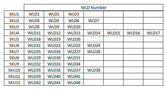

I am trying to get my separator to split the incoming items into 3 different items. In the attached model I have two different items arriving at Separator1 based on an Arrival Sequence. If the item that shows up is SKU1, I want it split into 3 different items. Ideally these would be labeled wld1, wld2, and wld3. Wld1 and wld2 would then go to Queue1, and wld3 would go to Queue2.
If SKU2 shows up, I want it split into 3 different items. Ideally these would be labeled wld4, wld5, and wld6. Wld4 would go into Queue1, and wld5 and wld6 would go into Queue2.
My thoughts were to set this up using a process flow that runs a subflow depending on what SKU# arrives at the Separator. In my full model I will have about a dozen different SKUs that will get split and go to different Queues. Below is a visual of what I am trying to do.
Thank you

This does work really well for SKUs needing the same number of splits. In my expanded model I will have 12 total SKUs. Depending on the SKU they could be split between 3 and 7 different ways. Below is what my expanded model will include. I don't have to have the 3D separator in the model. With this many SKUs and splits would going fully to process flow be the way to go?
One work around that I found was to split everything 7 ways, and then change the destination to a sink if they weren't all needed. For example, if SKU1 was split in WLD1 through WLD7, and I only needed up to WLD3 that WLD4 through WLD7 would end up going into a sink.
Thank you,
Eric
