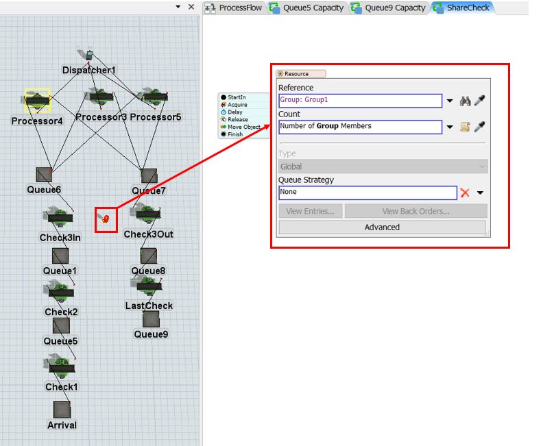

I have attached the model. Boxes are generated by Source3 in the 3D environment as seen in the image below. Whenever a box is created, the event triggered source "Source 3 Creation" creates a token in processflow. I then assign labels to each token to keep track of the order in which I will create boxes and the processors they have to go to. I then create the boxes in the "Arrival" queue and change the visual of the box.
The box then goes through the first check. Queue5 in front of Check1 can only have 1 box in it at a time. I use a subflow on "Use Transport" to check the contents of Queue5 and make the box wait at Check1 if Queue5 is occupied as shown in the image below. If Queue5 is not occupied, I move the object into Queue5.
The boxes then go through Check2 and queue in Queue1 before going to the third check. Queue1 has a maximum capacity of 2.
Check3In and Check3Out share the same operator. I used the same subflow on "Use Transport" for both Check3In and Check3Out as shown below to achieve this. When a box in Check3In requires transport, the "ShareCheck" subflow starts at the "StartIn" activity. When a box in Check3Out requires transport, the "ShareCheck" subflow starts at the "StartOut" activity. Both activity blocks starting with "StartIn" and "StartOut" aqcuire the same resource linked to one operator in Group1.
