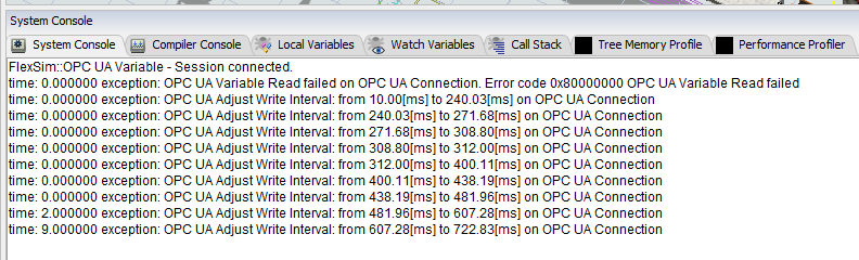

Also please find the system console error.
Message 15 of 17
jason_lightfoot_adsk
