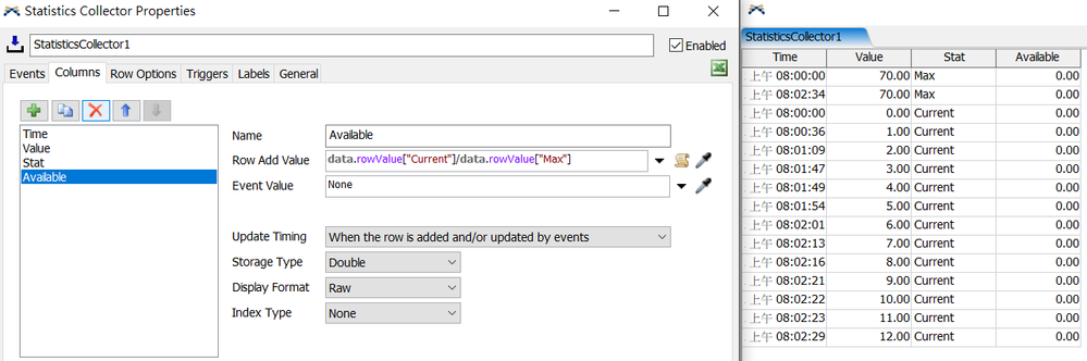

I tried to calculate available space of storage using this model. But I failed, how can I calculate Current/Max in Statistics Collector?available.png
Message 10 of 10
moehlmann_fe
Since you want to display the ratio you don't actually need the "Max" rows that are created by the first two events.
Instead you could add code to the "On Row Adding" trigger that writes the maximum content to a label of the collector when the first row is created. This can then be used to calculate the ratio in each row.
