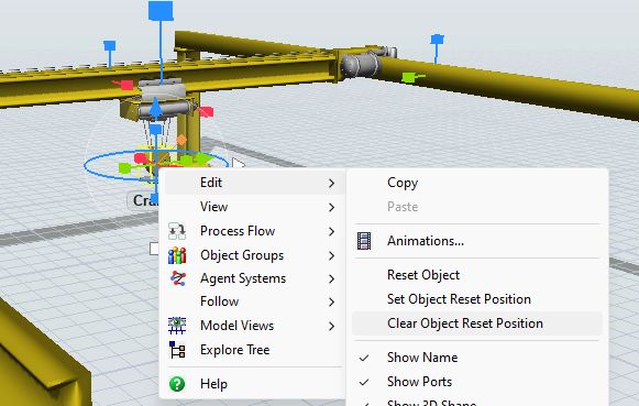

By default, the hook is near the ground,
is it possible to keep hook in air before simualtion start?
I tried to change the properties in tree, but it doesn't work.
Thanks for your help.

Moving the hook upwards while the model has not been started should automatically set the reset position to the new location.
You can also do so manually in the rightclick-menu.

It seems like my integrated video card's problem, thank you very much.
