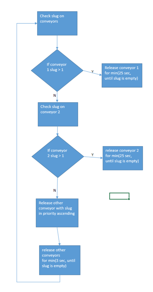

@Ryan Clark, thank you for the answer. I thought that time elapsed could only be used to build the slug, not release it. Wouldn't it mean that the conveyor 1&2 will have to wait until 25 seconds to build the slug before releasing it? I need to release slug on the conveyors 1&2 immediately after the whichever conveyor is being released right now, regardless of amount of slug built on the conveyor 1&2. (I've attached a process flow chart below) untitled-picture.png
Also the model is running into this issue after running it for a while. Attached a copy of the model. egmodel-merge-rc-processflow.fsm

I'm sorry for the late response! And sorry for the misunderstanding about your goal with this simulation. I've spent a little while playing around with it, and I don't know if the Gap-Optimizing Merge Controller is a good option for what you're trying to do. I would recommend creating a custom process flow to accomplish the logic you're trying to have.
I hope that helps! Let us know if you have further questions!
