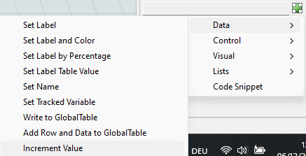

What I was trying to say is that you have to read the value of the label and add one to it, not just type the name.
The Increment option can be found at the bottom of the "Data" options.
Using it is pretty straightforward.
