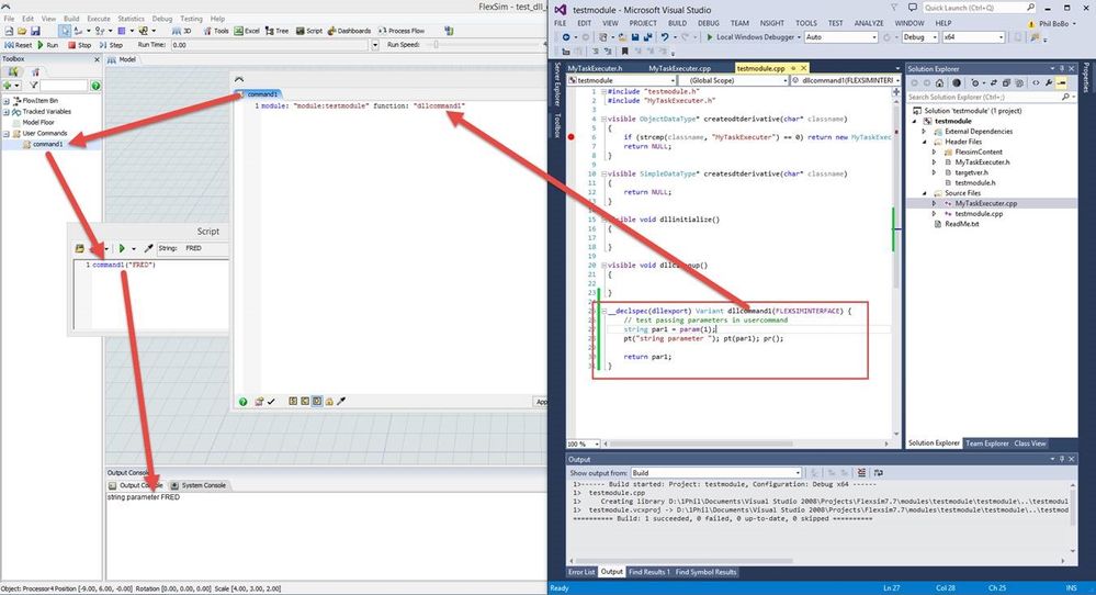

Change your function definition to return a Variant:
__declspec(dllexport) Variant DLL_GetDateTimeString(FLEXSIMINTERFACE)
  return std::string("Hello world!");
Phil BoBo
Sr. Manager, Software Development
mischa_spelt
Thanks @phil.bobo, tried that but then I get an exception as soon as I try to use the parameters. Turns out that the definition of the visible macro in basicmacros.h that we were using is still defined as
#define visible extern "C" __declspec(dllexport)
which is appropriate for functions returning double, but when returning Variant the function needs to have C++ linkage.
Replacing "visible" with "__declspec(dllexport)" as per your example solved the problem.
anthony_johnsonT83CM
Mischa, you are correct and this is by design. Dll functions that use the old method of returning a double should always be declared as visible double MyFunc(FLEXSIMINTERFACE) whereas functions that use the new method of returning a Variant should use __declspec(dllexport) Variant MyFunc(FLEXSIMINTERFACE). FlexSim detects whether the function is exported as a name-mangled c++ function (__declspec(dllexport)) or as a simple c function (visible). If it is the former, FlexSim assumes the function returns a Variant. If it is the latter, FlexSim assumes the function returns a double.
