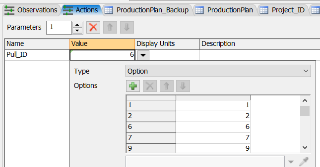

I need to pull items 1 to 50, but each is available only once. How to set the Action Parameters please? Shall I use Integer 1 to 50, or Options or anything else?1732266805649.png
How to remove already chosen action from the action parameters, so that in the next round RL algorithm could choose only from the remaining item numbers?

Since I wrote the question we have tried to use Options 1-50 and removed a chosen option from them after each round using GlobalVariables. Like this the random run in FlexSim works fine, each number is selected only once.
Here random run in FlexSim - chosen numbers are removed from GlobalVariables and Options are updated according to it:1732890228338.png
But when we run RL, Python script reads the Action Parameters probably only in the beginning of the training and chooses the same numbers repeatedly. As they are not available in Options any more, FlexSim uses the last row from the Options instead. Like this the RL agent cannot learn properly. There is also confusion with rows and numbers on them (third row has number 6, which is then used in the model...).
Is there any possibility please, how to update available Action Parameters into Python after each Action?

As far as I can tell, the general idea would be to use a single action: which job should be started next. For that, I probably wouldn't use a sequence parameter, but instead discrete parameter from 1 to N. Note also that if you train an AI on a certain number of jobs, you'll always need to supply that number of jobs.
But then, when a job is chosen, you'll need some way to specify that the job isn't available anymore. For that, you'll need something called an action mask. It looks like you can do that with a Maskable PPO algorithm:
https://sb3-contrib.readthedocs.io/en/master/modules/ppo_mask.html
In addition, you'd probably need to send some kind of state information about the current process so the agent can learn to make good scheduling decisions, as part of your observation.
