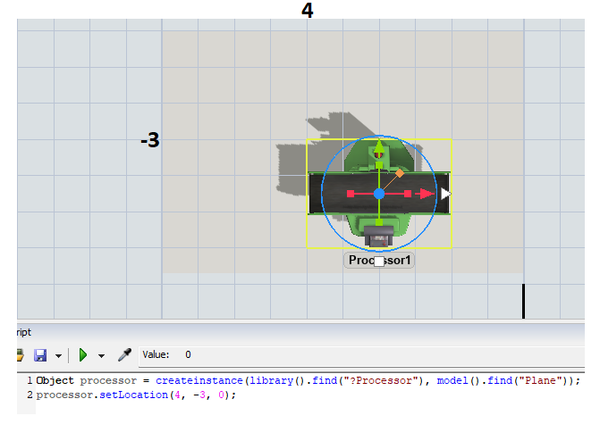

Skovdestudents
Good idea! We have an issue with creating the object in the plane though...
We create the plane as intended but...
We create a processor like this:
createinstance(library().find("?Processor"), model());
We have also tried: createinstance(library().find("?Processor"), model().find("Plane"));
and it does not work.
We have also tried the moveobject function but no luck either..
What function can we use to move it to the plane? and if possible also move it to a specific coordinate in the plane, rather than using Vec3?

FelixMoehlmann
It's hard to know what is going wrong without access to the model.
Is the plane itself a subnode of another object? In that case you have to give the whole path or use the "?", like you do to find the processor in the library.
createinstance(..., model().find("ContainerObject/Plane");
createinstance(..., model().find("?Plane");
Once the object is inside the plane, you can use "object.setLocation" to change its location. This will use the coordinate system of its direct parent node, so in this case, the plane.

jason_lightfoot_adsk
Object plane=Object.create("VisualTool");
Object.create("Processor").up=plane;
