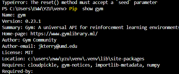

philboboADSK
Your comment doesn't describe the problem you are encountering now, just a screenshot of a code snippet.

a9080109
@Phil BoBo @Jordan Johnson @Joerg Vogel @Kavika F @Felix Möhlmann
I'm having the same problem, but there is still no good way to solve it, I'll provide my code and related versions, I hope it can help me solve the problem, thank youflexsim_training.pyflexsim_training.pyflexsim_env.py1721305561181.png1721305666664.png
