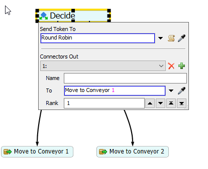

How can I alternate the release of conveyor 1 and conveyor 2 using the process flow that I have? Currently when the conditions are met both conveyor 1 and conveyor 2 both release causing a backup in OP10_Load due to max queue content restriction.

Additionally, you can always use the round robin option in a decide activity to alternate between Conveyor 1 and Conveyor 2 in your model. Simply place two move objects after the decide activity as follows:
