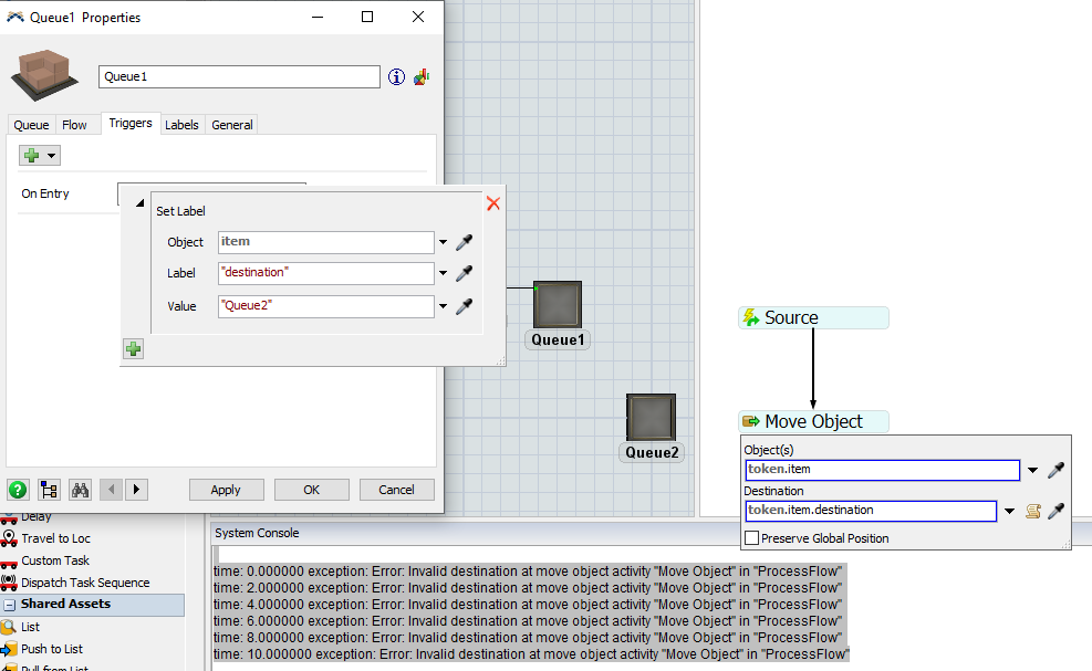

As shown in below image, Queue OnEntry label destination value is Queue2 . In ProcesFlow MoveObject Destination is written as token.item.destination is throwing error.
Here doubt is Queue OnEntry how to keep location labels.

Your label seems to be a string and not a pointer. Please add the value by the sampler tool. It will look like
Model.find(“Queue2”)
Maybe you should add a delay activity previous to the move object activity, because the order of both On Entry events (trigger and activity) isn’t exactly sure.

Thanks for your answer. It is working now
