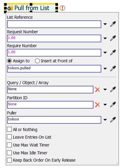

token.pulled? && token.pulled.length >= 1<br>
Could you please explain token.pulled? . Here ? will search whether pulled label is Null or not. Is my understanding is correct.
What I am looking for is I am trying to fill a Truck with different dimensions parts. So Once the Truck is full only it can dispatch. Is my approach of sending the parts to List and once the required quantity is arrived pull from list is correct approach or could you please recommend if any better solution.
Message 8 of 9
regan_blackett
@Sudheer R
Maybe a Batch activity with a Label quantifier would give you what you need with a lot less work? See the properties below.
With the quantifier set to your label Value, the Batch will try to collect the Batch Quantity. If it can't collect the full amount, it will let the the token that would have put the Batch over it's limit be part of the next Batch and the collected amount is released as a single token that could represent your truck.
IN the label aggregation section I just added those in so you can see the individual Values of the batch members as an Array, as well as the total value of the Batch.
Message 9 of 9
regan_blackett
Regarding the Start Criteria for the Max Idle time:
token.pulled?
Means to return a nullvar if the pulled label doesn't exist, which is treated as 'false' for the Start Criteria. So it can essentially be treated as saying "if the pulled label exists and it has a length of >= 1" then use the Idle timer. The previous Start Criteria threw an exception because it tried to access a label that didn't exist.
