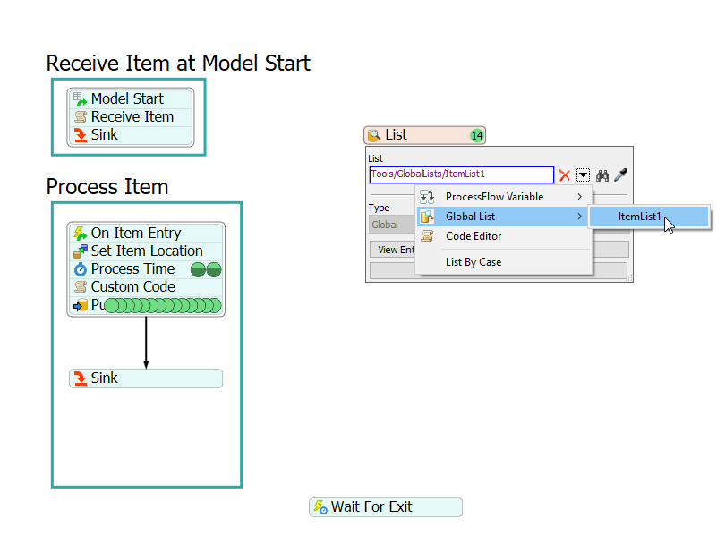

Hi!
I am trying to make a model in which I need to insert items in the same list from multiple instances, but I can only insert in the list the items processed in the first intance. If an item passes through the second instance, the model generates an error
Could you please help me with this error? Thank you!!

@David Chas
It looks like you didn't have a List connected properly on your Push to List. I copied and pasted the List from your Basic Processor 2 Process Flow and moved it into the Basic Processor Process Flow. Then under List Reference within Push to List, I used the eyedropper on the List. Then I went into the List and changed it to ItemList1. See attached images. I have also attached a model with the changes I made. Let me know if this helps.
