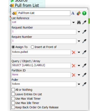

arunTTT2P
Since the label fields were available in the list. SELECT query in the pull-from list can also be used instead of assigning labels.
jason_lightfootVL7B4
Note that this requires the option to assign select values to the pull as defined in the List General Properties:
