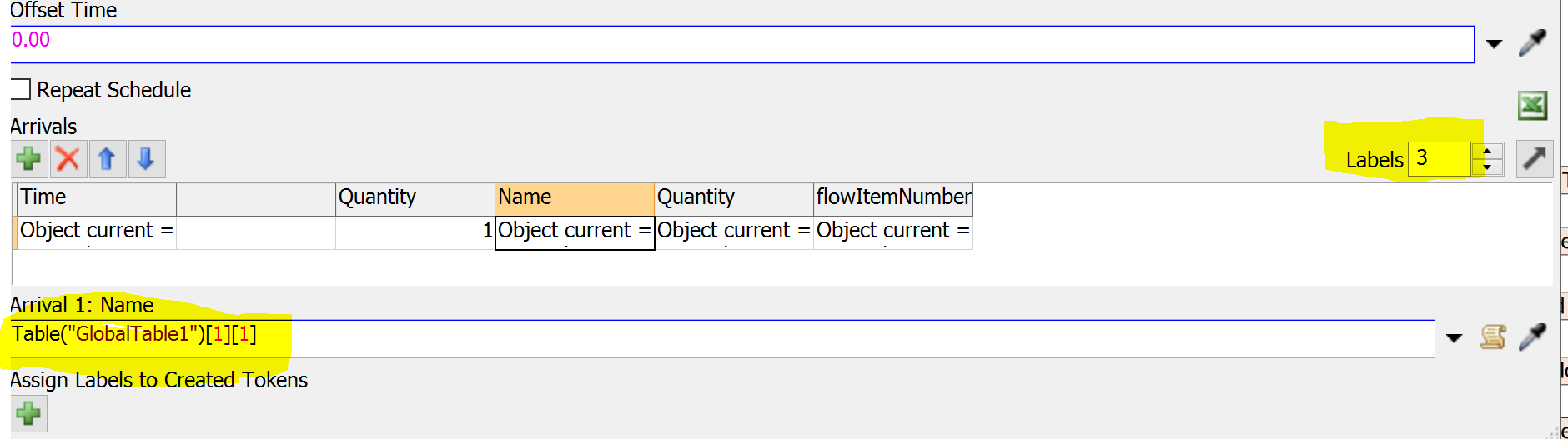

@Daniele S I think you're headed in the right direction! To help I created a simple process flow consisting of 3 things: source, create object, and a 1 line code snip.
1. On the source create labels that directly reference back to the table. The format for the reference is:
Table("tableName")[row number][column number]
So on your source add labels to your created token then for each label put the reference to the cell in the table.
2. Create an object in the queue. If you want to put the labels from the tokens to the item itself when you create an object add a label. Make the value token.label. For example, if I want the Name label from the token put on the item. On create object I created a label value token.Name.
3. Create a custom code to change the shape. I sued the function setobjectshapeindex(object, flow item number). What's cool is that you can reference a 3d object in your flow item using the number that is is on the list of flow items. i.e a box = 1, sphere = 3, W23_180_ = 14. I created a label in the last column of the table called "flowItemNumber" as the reference.
I put the flow in a box Test Example in your model. Hope this helps!10228-simulation-process-multipleobjects1-05m01.fsm
