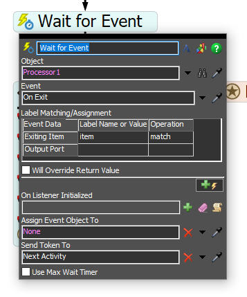

I'm making a flexsim model where I want a box processed and then a transporter should take the box into a rack. However, the transporter is taking the box into the rack before it has gone out of the processor.
I think the problem is I'm mixing process flow with 3D, but I'm not sure how to fix it. I tried doing the transportation without process flow, just 3D and it worked, however, I want to make it in process flow because I wanna keep the tokens so later I can push them into a list to know my inventory.

Hey @Lexi, if you want to wait for the item to finish processing at the Processor, you can use a "Wait for Event" activity. I set one up to wait for the Processor's On Exit trigger (fired when an item leaves the processor). I also make sure that the leaving item is the one that matches the one you labeled earlier.
Now it should work!
