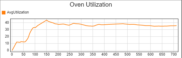

Hi good afternoon,
I'll like to learn about best practices in a simulation of a shopfloor in which there is an oven and need to take note of the oven's utilization, which way is the best implementation to show the utilization without statistics from conveyor and zone in process flow?,
I prefer the pie chart to show this but there are some metrics in the simulation attached that are not the most fileworthy to show,
thank you for your support, i'm learning a lot with you guys 🙂
Best regards! OvenUtilization.fsm
179 Views
jason_lightfoot_adsk
Here's a stats collector that you can show the instant usage.
And the tracked utilization over time (tracked variable on the conveyor).
ovenutilization_jl.fsm
LuisGaytan
That's exactly what I want, thank you a lot @Jason Lightfoot I really appreciate!
