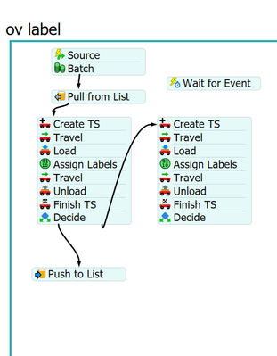

I now observe that my model will move three batches, each batch has eight items! But I expect it to only grab one batch at a time. How should I adjust my model?
I know I can adjust the quantity in my picture~! But I can only complete one batch? How can I adjust it to what I expect?

In addition, if I want to adjust the number of batches I take at a time and how many pieces I should count in a batch, how should I choose the whole number?
Message 12 of 12
moehlmann_fe
To only move one batch at a time, do the load, travel and unload actions all in a single subflow.
The items are split into batches in the Assign Labels activity above the Run Sub Flow activity. The total number of items is still determined by the Batch activity at the start of the flow. Make sure that the number of batches and number of items per batch are chosen such that all items can be assigned a batch and that there are no empty batches left over (a partial batch at the end is fine).
