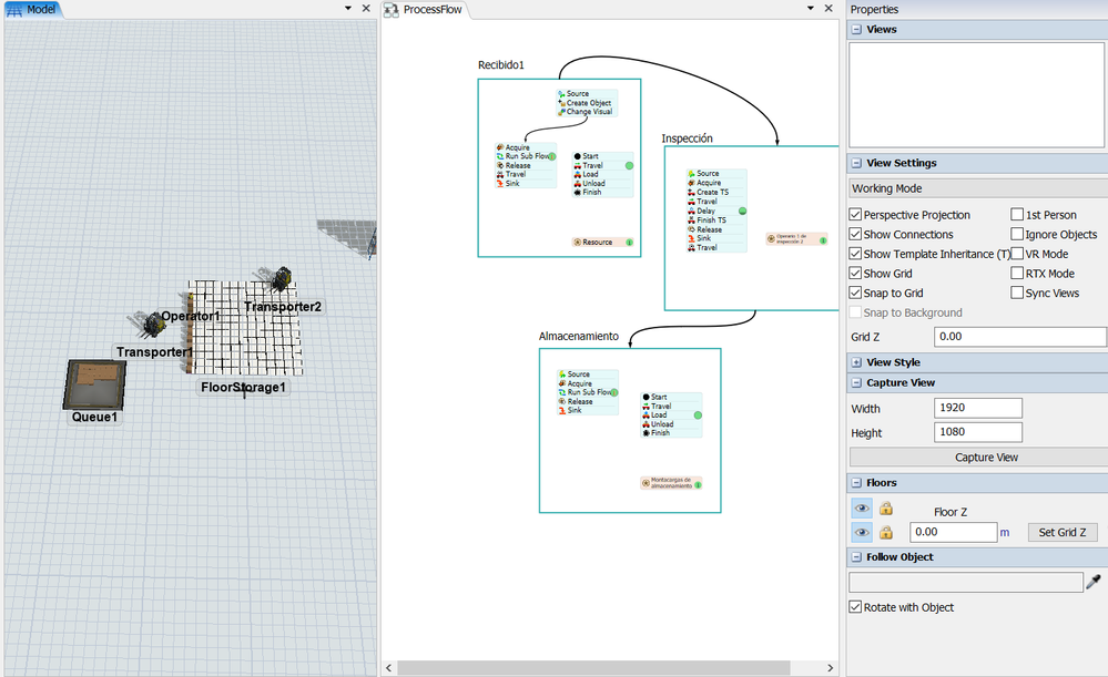

I have a problem with the storage forklift. I am configuring the event so that when there are 33 products in the warehouse floor, the forklift goes for them; but it generates the following error.

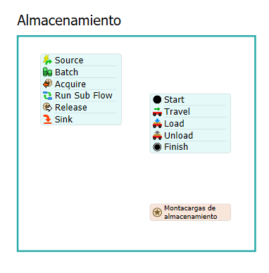

The problem is that your Producto label is just a number not an array of pointers to flow items. To fix this I changed you event triggered sources to be for on entry to the LFoor storage and then added a batch activity for 33 items.
