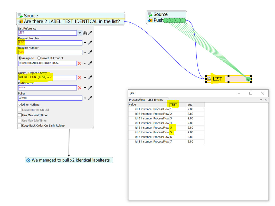

Please help me, I am stuck...
I want to pull x2 tokens only if they have the same label "TEST" value in the list.
I do not care what value it is, just the fact that they have the same label value means that I want to pull them.
Any idea? I tried the function "COUNT()"but it didn't seem to be recognised by the Pull From List activity.
