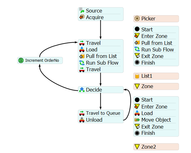

Adding the same file here, found this while going through the process flow, is the '4' in red indicate the number of tasks left to finish the cycle? cause that's how it matches the number 5(4 yet to start and 1 ongoing)

The Source creates 5 tokens. Each of those then pulls "order tokens" for one order number and vanishes in a sink once that order was picked.
There are multiple ways to allow more orders to be completed:
1. Create as many tokens as there are orders.
2. Have a single token loop through the Process Flow indefinitely, increment the OrderNo label between each cycle.
There is also another issue. When the assigning the Type to the tokens "gettablenum()" is used. But there are two type values in the tables that are strings (text) and not numbers. These will be interpreted as 0 and thus not match the Type label on the items.
The newer syntax "Table(tableName)[row][column]" should be used to assign the labels, so they can be of differing data types.
