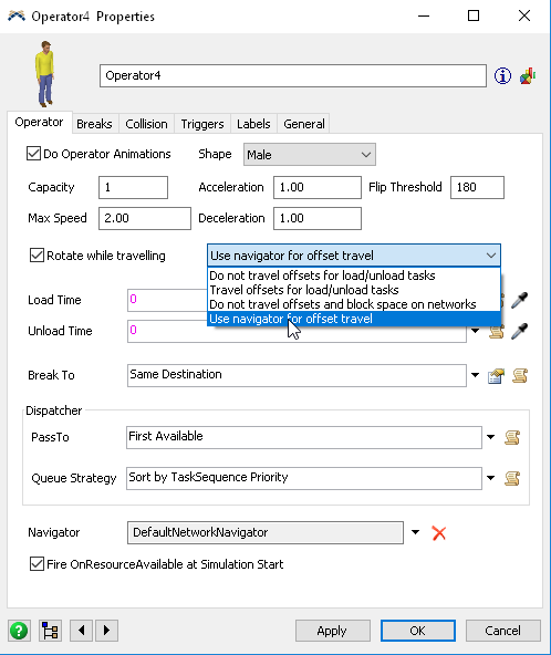

presentation-autosave.fsmWhen the transporter unloads or load a flowitem the transporter visually intersects with the flowitem and when unloading the transporter waits in the the middle of the flowitem until the transporter is called on again. How can I fix this. I attached a picture.

@Shawn D Have you tried using network nodes?

The Taskexecuters have to go somewhere to load. It is the center of the item they are going to load. You can find it really easy if you high light the item. It is then surrounded by a yellow frame. There are two possible solution, since Flexsim won't make a physical realistic simulation in the near future. You can force the taskexecuter to use the pick offset tasktype while the transport tasksequence is executed. This tasktype can define the ratio of the travel before the item is loaded. My favorite is the second variant. You can distinguish between the object size and the shape size of an object. The object size can be in this variant much smaller than the shape size. If you change the object size in the manner that the yellow framed object is a small cubic at a side or corner of the box and the shape keeps its current dimension then the taskexecuter is still going to the center of the yellow framed object but not anymore to the center of the shape. The disadvantage of this variant is you have to adjust the position of the yellow frame by source code to the optimal location in relation to the shape before the transporter is executing the Tasktype frload.

How do i adjust the position of the yellow frame? I don't know what source code is or how to find it, and i don't code.

If you have specific places you want the traveler to go when loading or unloading boxes, the best way to do this in my opinion, is to have a travel network of network nodes. And then in the traveler's preferences, make sure you select "Use Navigator for Offset Travel"
By selecting this, it makes sure that the operator will not leave the nodes to load and unload objects. So you can place nodes directly where you want the traveler to be when loading or unloading from the queue.
