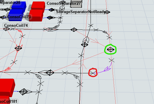

The CP circled in green in the screenshot below has two outgoing "NextWorkPoint" connections. These will be used by the AGVs in alternating order. In the model you uploaded the purple path is not properly connected (red marker shows the connection that is missing). So even AGVs that travel to the NextWorkPoint on the left will drive past the Source. However, they only check for tasks at the next work point that is 'logged in', so they ignore the items at the source. When an AGV does choose the lower path it will in fact pick up additional items.
In order to suggest any changes, you would need to explain in what way the AGVs should behave differently.
And the storage currently has infinite capacity, because the items are not stacked in the z-direction. Though if you add that you will get an error once the storage is full, because it will pull items regardless of whether there is a slot for it or not. A simple A-connection from the source to the storage would handle this on its own.
