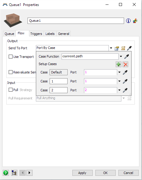

I am trying to figure out how to create a batch process where 15% of the time , the batch goes to Port 2 and the rest of the time goes to Port 1. By doing 'By Percentage' it only moves part of the batch to Port 2 and not the whole batch. Can you help?

Maybe you could try this. It`s not elegant but it works:
Put a numlabel on the queue that produces the batch and call it e.g. "path"
On the OnEndCollection Trigger you just write this:

To make this work you just use the label at the the Send To Port trigger
mischa_spelt
Actually you can replace your whole code with
setlabel(current, "path", bernoulli(15, 1, 2));

Thanks guys. This worked in my simulation. It saved me some time trying to figure this one out.
