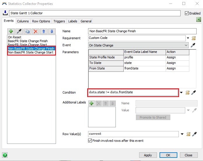

As a workaround, to count overlapping breakdowns as one, you can adjust the statistics collector of the gantt chart.
First, install the components of the chart. Be sure that the settings of the chart as how you want them before you do this, because this will disable some interface elements, such as the object selection.
Then open statistics collector that should appear in the toolbox and add the condition that the 'FromState' and 'ToState' have to be different for the collector to add a new row in the 'Non BasicFR' events..
You now won't get two successive rows with the same state, bundling overlapping failures into one row.
This results in the expected MTTR values; slightly higher for Processor2 than Processor1.
