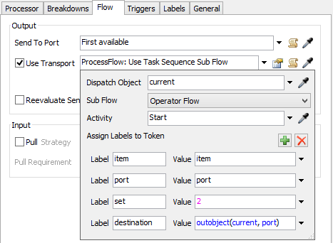

For each 3D processor, I set the process time to zero; the Sub Flow handles the process time. Then, like the tutorial, I configured the Use Transport option to use a Sub Flow (which used the Per Instance option):
Notice that the Dispatch object is current, unlike the tutorial, which uses centerobject(current, 1). This means the keyword current will refer to the calling processor. Also notice that I store the item that needs transport, the set that the processor is in, and the destination of the item as labels on the token.

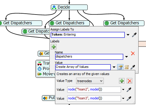

Now we move to the Sub Flow, which I named Operator Flow. The first Decide activity uses the "set" label to determine which route to go down. Each "Get Dispatchers" activity creates a label called "dispatchers", which is an array of all the dispatchers that could be used by that set. For example, set 3 can use operators from Dispatchers 2 and 3:
Once the set of possible dispatchers is assigned, we can pull from the list with a query:
This pull from list can be read as follows: Get a single operator whose dispatcher is in the label array of dispatchers. Put that operator on my operator label. The token waits until it can get the right kind of operator.
