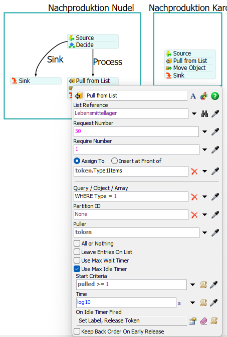

In the Move Object activity you use the label "Type1Items" which does not exist on that token.
You do not have to run the Move Object per item. It is one of the few activities that can process an array of values at once. So instead of running the Sub Flow over the items inside one object, you can run it over all objects inside a group (everything you want to empty) and move all items from each object at once.
You should also deal with the other compiler errors.
- In the Run Sub Flow activities for the individual foods you have to remove the second dot between the "Type1Items" and "[creationRank] in the expression "token.Type1Items.[creationRank]". The index follows directly after the array reference
- There is a faulty expression field in List1. (Second "age" field).
- You typed "Log10" in the idle time field of a Pull from List activity without providing the parameter (the number of which the logarithm should be calculated).
