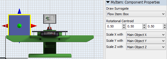

I keep seeing these midpoint indicator arrows in tutorials, but in my animation editor, all I see is the move and scale indicators. How do I turn the midpoint indicators on?

The upper screenshot is from an earlier version where the manipulation orb that allows to resize, move and rotate did not exist yet. The arrows in the lower screenshot also positioned in the middle of the object by default though.
In both cases they technically are positioned based on the "Rotational Centroid" values you see on the right in both screenshots.
