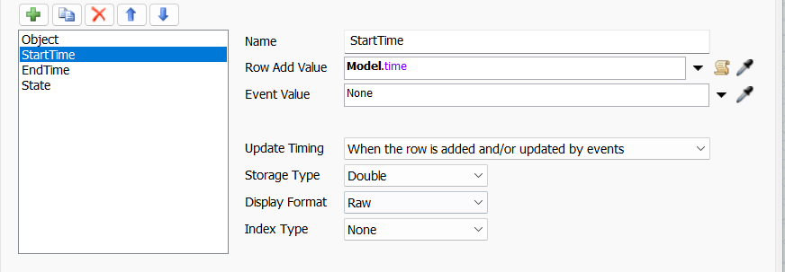

Is any option to force Gantt Charts show start time and end time as hours instead of date format?
I have tried several workaround like the following but so far I haven't work it around... It says "Error in time columns" when plotting it yet the smart collector table show right values.. would of much help to compare it visually with other Gantt for planning validation.

The Gantt chart currently only supports data in DateTime units. I'll add a request to the dev list to add this feature to the Gantt chart.
