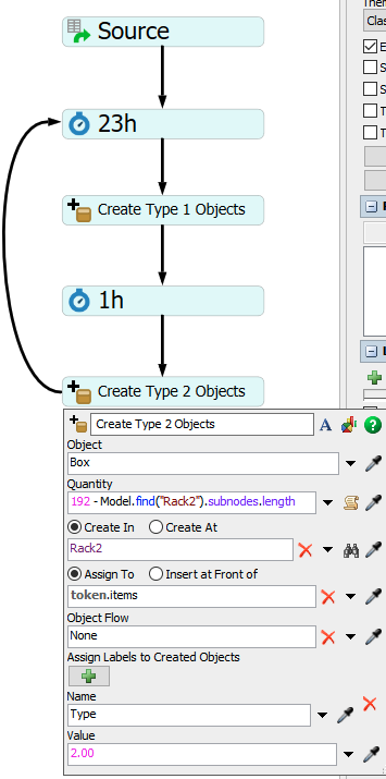

moehlmann_fe
You can of course modify the process flow to delay the creation of the type-2-items for an extra hour.
In your original question you said you wanted to create the items in queue1 (if the translater is correct), to create them directly in the racks you can change the "Create In" option of the process flow activities.
automatic-rack-5.fsm
Google Translate:
Por supuesto, puede modificar el flujo del proceso para retrasar la creación de los elementos de tipo 2 durante una hora más.
En su pregunta original, dijo que quería crear los elementos en la cola1 (si el traductor es correcto), para crearlos directamente en los racks, puede cambiar la opción "Create In" de las actividades del flujo del proceso.

You would simply add more "Create Objects" activities in the correct order and set to assign the respective item type. If needed you put delays inbetween them to achieve the desired creation time for the items. Just make sure that all delays (except the first offset to skip the first day) add up to 24 hours.
Also, you might want to use the pull strategy on queue2 and queue3. Otherwise the first connected rank will have priority and hardly any items will be send from the other racks.
automatic-rack-7.fsm
