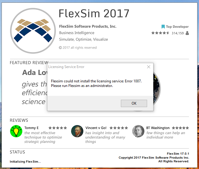

Looks like i have to install the flexsim software to run the models on my computer
It works for Flexsim 2016 update 2 but not for Flexsim 2017
it gives me licensing error
I would like to run the model without installing the software
FYI..the user is admin for his computer
philboboADSK
In order to open FlexSim, the license service needs to be installed. The installer installs it. FlexSim itself will also install it when you run FlexSim as an administrator.
Running a program as an administrator is different than just running a program while logged in with an admin user. You have to actually explicitly tell it to run as an administrator by right-clicking the program and selecting "Run as administrator."
You can also right-click a shortcut to go to its Properties and set "Run as administrator" in the Advanced Properties of the shortcut.
You might also be able to install the licensing service directly from the DLL in FlexSim's install directory. The file FNP_Act_Installer.dll has an exported function called fnpActSvcInstallForMSI() which you might be able to call directly from VBA. Figuring out how to do that in Excel is beyond the scope of FlexSim technical support though. If you want to go that route, it is up to you to try to figure out how to do that.
