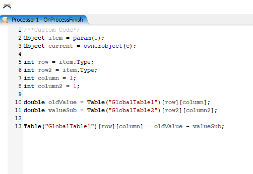

Second, once you have imported your Global Tables, you'll need to change the code so that you're accessing the current INV value and then subtracting the BOM value from it. I think you called this "- X". The new script for the OnProcessFinish Trigger looks like the image below. Note that I used two row and column values in case you choose to alter those.
Hopefully this helps. Of course, you're probably going to need to designate more functions, such as what happens when the INV levels are insufficient and such. This will all require using a lot of custom code. Before taking on a large model, you might consider talking to your local distributor about consulting. There are many ways to utilize FlexSim and we would hope you can find the best one for your simulation.

One clarification I might have not made. When the Processor1 is outputting 1 item, the change in INV should be : (with N being the last qty in the Inv column)
Item 1 = N-2
Item 2 = N-1
Item 3 = N-1
Item 4 = N-10
These 4 subtractions should,happen every time Processor1 output qty 1
Right now, the model is doing one item after the other only.
Marco
Message 11 of 11
tanner_p
Instead of using item.Type, just update the code to run a "for()" loop for each row in the table. That way, it will decrement each row for each item. Hopefully this helps. Please see updated model attached.
