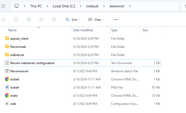

Can you please help me with connecting webserver with IIS. I did all the steps given in documentation. However, I am not able to see FlexSim WebServer on IIS?
1710801848167.png1710801855527.pngPC IIS
Below image is from flexsim documentation:
1710801898899.pngimage from flexsim documentation.

Try setting that for the default web site and start the service to see if you can browse the server at the localhost address.
Message 3 of 10
Urvi_Sukharamwala
Yes, I can browse the default website on localhost. After adding all the files and folder of flexsim, I can not see flexsim under site in connection panel.
Message 4 of 10
jason_lightfoot_adsk
But is the default website the Flexsim webserver or the IIS test page?
Message 5 of 10
Urvi_Sukharamwala
IIS Test page
Message 6 of 10
Urvi_Sukharamwala
If I try to run FlexSim webserver from the folder, it shows error
Message 7 of 10
Did you run if from the webserver program install folder (not web root) first (as the instructions say) - and did that work?
Message 8 of 10
Urvi_Sukharamwala
I think I forgot that step. Should I delete all the settings and do it from the beginning?
Message 9 of 10
I would try that.
Message 10 of 10
Urvi_Sukharamwala
Hi Jason,
Thank you for the response. I forgot to update on community that, I deleted and did all the settings from the beginning and it works now.
