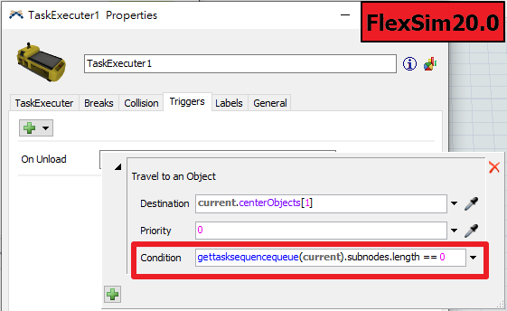

I found the condition "Travel to object" condition is because the version is different. I found the condition is because the version is different.
Can you assist in updating "Travel to Object"?

The source code header is wrong declared for the variable current. It is declared as Object, but it must be Dispatcher. Dispatcher inherits Object Class, but not other way around.
joerg_vogel_HsH
@phil.bobo, maybe you can put it onto the dev list to check the headers or to cast directly from Object to Dispatcher if properties or methods of TaskExecuter Class are involved. Many Thanks!
joerg_vogel_HsH
The difference comes from introducing a property of TaskExecuter class. gettasksequencequeue is still an old command of the pre-dot era. Dispatcher.taskSequences is an actual class property. It is time to change from commands to class methods and properties whenever it is possible. Otherwise we will never have an progress towards classes, if the picklist options don’t show the whole new syntax.
Probably you can use,
content(gettasksequencequeue(current)) == 0
but “content” is already deprecated, so will be “gettasksequencequeue” in one of coming versions.

Thanks for pointing this out. I've added a case to the dev list.
In the meantime, you can press the down arrow to get the previous condition.
