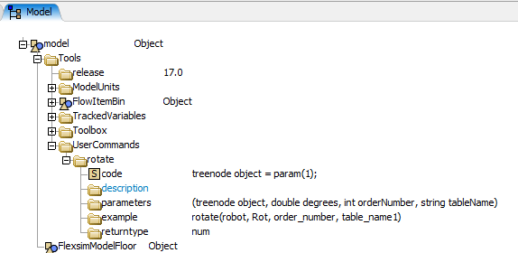

"rotate" is a user command,how can i use it in DLL
19 Views
mischa_spelt
User commands are stored in the tree under MODEL:/Tools/UserCommands/rotate. Their code is stored in the first subnode which is usually called "code". 4508-usercommandintree.png
You can use the nodefunction command like you would normally to execute the user command, from the DLL:
treeonde rotateCommand = first(node("MODEL:/Tools/UserCommands/rotate"));
double result = nodefunction(rotateCommand, robot, Rot, order_number, table_name1);
Note, however, that this makes your DLL non-reusable by another model, unless that model also happens to have the same user command.
You may want to consider implementing the rotate functionality in the DLL instead:
visible double rotate(FLEXSIMINTERFACE) {
and then linking the user command to the DLL function, as described in the Module SDK documentation:
