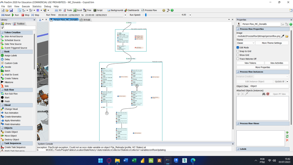

Hello! I'm developing an academic work with the objective of simulating the Mc Donald's production line. I'm new to Flexsim and I have a few questions to get the kitchen operators to start executing orders as soon as customers place their orders with the cashier.

You can use the split function and then the join function. Split will split your token in two. One for the customer to wait for the order at the table, and the other for the employee to place the order. The Join function joins the two tokens (they manage to match according to a label) and the flow continues normally with only one token representing the customer. I am attaching a print of how the process flow would look and an example in FlexSim.
