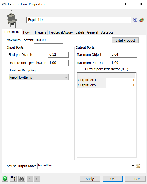

I need to be able to use recycled objects (enabled by ItemToFluid's "Keep FlowItem" option) and send it to a queue. The simulation is a process of squeezing oranges where the juice will go to a FluidProcessor through port 1 and the residue (FlowItem) I must send it through port 2 to a queue.
An important detail is that every time an orange enters, the value changes by code of the "Fluid per discrete" and "Maximum Object" this for the calculation of the squeezed juice.

You can use a separator. Connect your conveyor to a separator and then connect the separator to your Item To Fluid and the separator to your Queue. Select "Values by Case".
