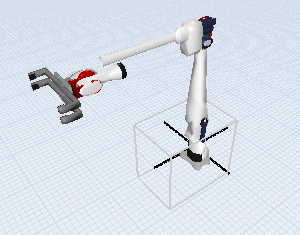

How to save the rotation of the object? in my example Robot. Because I change the details in animations window and on reset the rotation goes back to the default.
I save the base postition.
I want to look like this, I save, but on reset it goes back to:

Do that via the model geometry editor where you will see "Reset Position to current" button at the bottom right.
