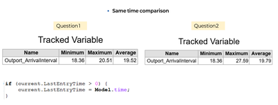

In Question2, the calculated interval includes the first arrival time.
Because of this, the average interval value is higher than expected at the beginning.
What I want is:
The first result value should be
→ (second arrival time - first arrival time)
To solve this, I modified the condition in
Statistics Collector → Triggers.
The first arrival time is still included in the result
How can I exclude the first arrival from the calculation?
Message 8 of 9
FelixMoehlmann
For the collector that uses the label on the object you can use the Condition field on the Events tab to not generate a row for the first event.
With how the other collector is currently working it needs that row to calculate the next interval. You could at most return some placeholder value for the interval and later exclude it from the query in the Calculated Table (partition).
Message 9 of 9
ayeong_jo
